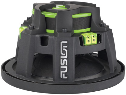

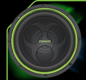

jinak ze starsich SW mam Fusion PP-SW12E
Max Power Rating (Watts): 900
RMS Power Rating (Watts): 300
Coil Height (Hvc): 25
Compliance (Cms): 248.25
Cone Area (Sd): 49.09
D.C. Coil Resistance (Re): 1.82
Electrical Q (Qes): 0.39
Force Factor (Bl): 10.38
Free Air Resonance (Fs): 27.64
Frequency Response: 22Hz - 500Hz
Gap Height (Hag) (mm): 8
Impedance (Nominal): 2
Inductance (Le) (mH): 0.27
Linear Excurson (Xmax):28
Mechanical Excursion (mm):8.5
Mechanical Q (Qms): 4.65
Moving Mass (Mms): 133.6
Sensitivity (dB) (1W/1M): 88.5
Total Loudspeaker Q (Qts): 0.36
VAS (L): 84.94
VAS (CuFt): 3
Magnet Structure (Oz): 176
Total Loudspeaker Displacement (L): 7
