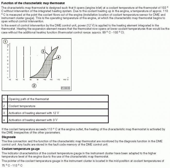

Kratky popis fuknce a chovani v aute nekoho jineho (a dava smysl)...
The BMW electrically controlled thermostat operates like a standard wax bi-metal one, but maximum opening is electronically controlled. It does this by means of a heating element that's activated in order to further open the t-stat when one or more of the following inputs to the DME meet preset parameters:
- vehicle speed > 176 km/h
- engine temperature is over 113C -- sensor at the rear of the head.
- radiator outlet temperature becomes excessive as defined by BMW (this is the sensor in your rad hose)
- high engine load = injector pulse width > 5.8 milliseconds.
- air intake temp. > 52C
So at low to moderate loads, the engine temp will run from the mid-90s all the way up to 113C in order to maximize fuel efficiency. Under high loads, the T-stat will fully open and the engine will run in the high 70s to mid-80s which, in turn, calls for a richer fuel mixture in order to avert pinging.
The fact that the engine will run so hot under "normal" conditions might also help to explain why the plastics and rubber under the hood deteriorate more quickly.
I had to leave in the wee hours this morning to deal with a jobsite emergency, which gave me a chance to monitor coolant temps. before many other cars were on the road. My data at 11C ambient temp. and a new T-stat:
1) Cruising at 70-80 mph in 5th gear: 95C
2) 0-80 mph wide open topping out in 3rd gear: Temp. goes from 95C to 81C in about 1 minute
3) Back up to 95C in 2-3 minutes driving in 4th gear at 40-45 mph.
4) 3rd gear at 5K RPM & 80 mph: Coolant temp. goes down to 77-78C in about 1 minute.
5) After 3-4 minutes in 5th gear at 60-70 mph, temp. rises again to 95C.
6) 93-95C in 5 minutes of city driving.
7) Gets up to 97C while parallel parking in front of my house. End of Test.
