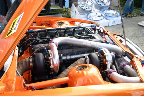

kluci ve Svedsku v VS Motor maji dlouhou chvili :-)
cele info: [ Link ]
Motor Volume 3.9l,
2 x Turbonetics T66BB turbo,
VS exhaust manifold,
carbonfibre intake manifold with single plenum VS/Fibervac,
Ported head with custom VS Camshafts
Autronic Sm2 management with Msd Dis 4
1640cc injectors
Engine Torque Output (on an engine dyno)
3000 rpm - 420Nm with 0.2 bar
4000 rpm - 510Nm with 0.3 bar
5000 rpm - 900Nm with1.2 bar
6000 rpm - 1610Nm with 2.3 bar
Power 1422Hk/6700rpm Torque 1610Nm/6000rpm

asi jsem zabrzdenej, fakt nechapu souvislost mezi "Power 1422Hk/6700rpm Torque 1610Nm/6000rpm" twin turbo e36 zastavbou od VS Motor a nejakym prumernym kompresor kitem na Mustanga s blbe umistenym vzduchovym filtrem... ale to je fuck...

slusnej vykon....
